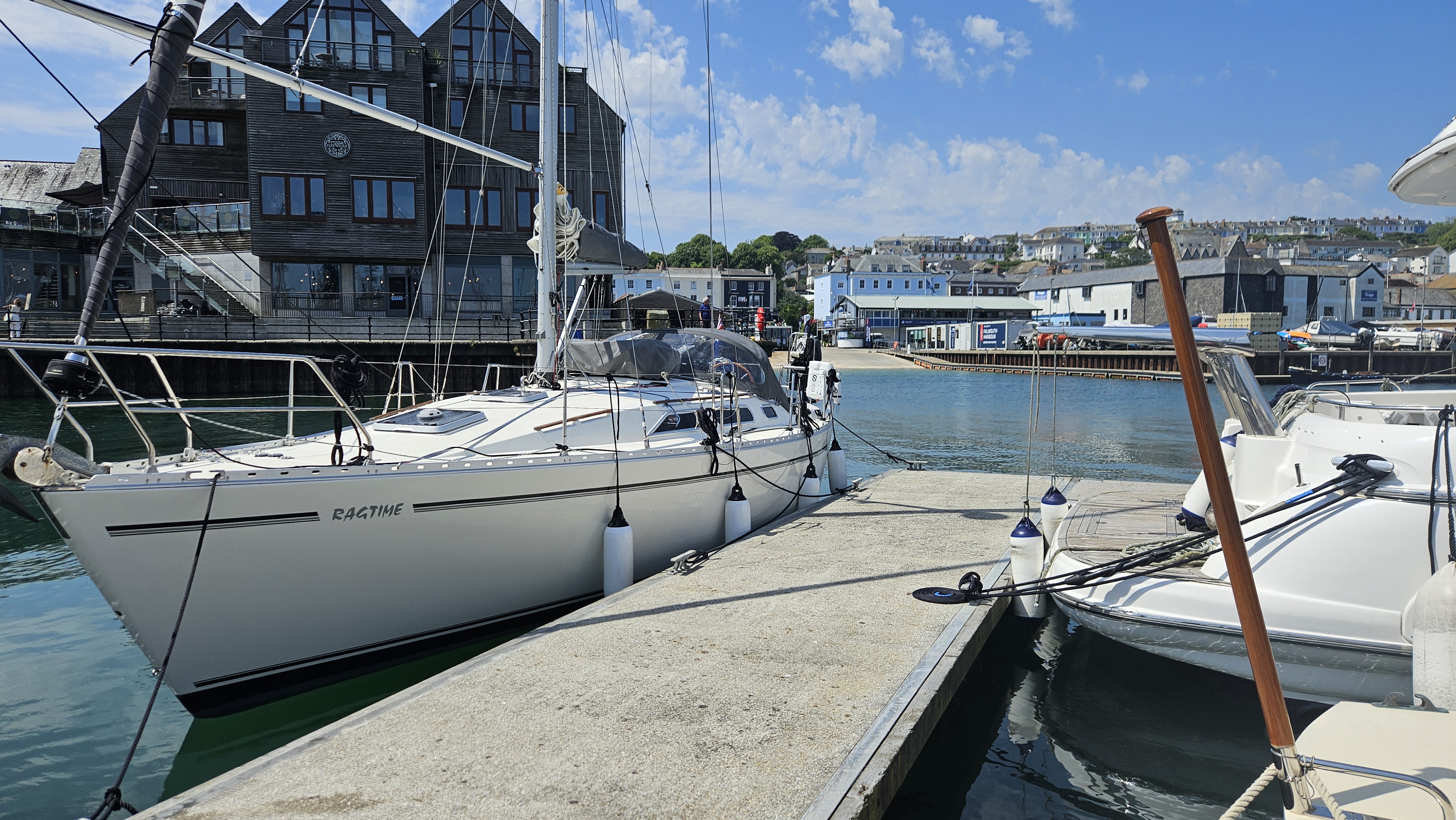

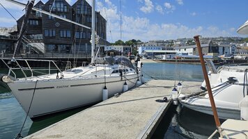

We are planning on entering Ragtime, a fin keel 336 mk1 in the 2027 AZAB race. I attended the RCYC AZAB 50 celebrations last week and met the owners of Franglais, an almost identical 336 which completed the race double handed.

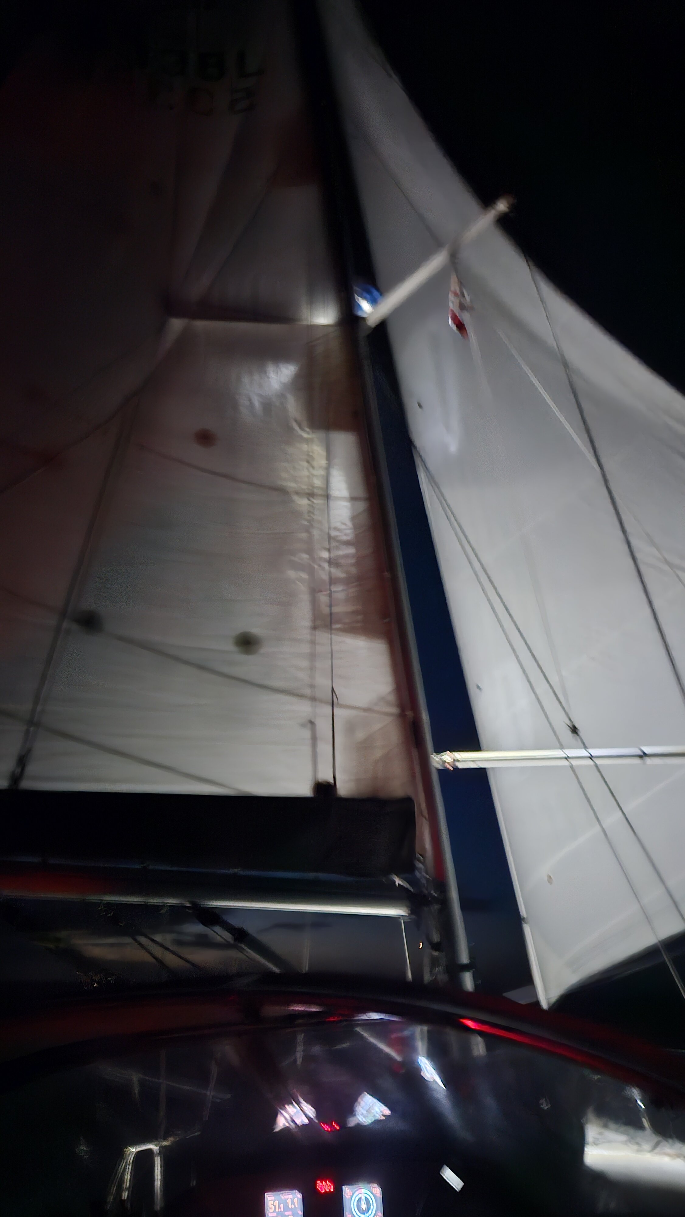

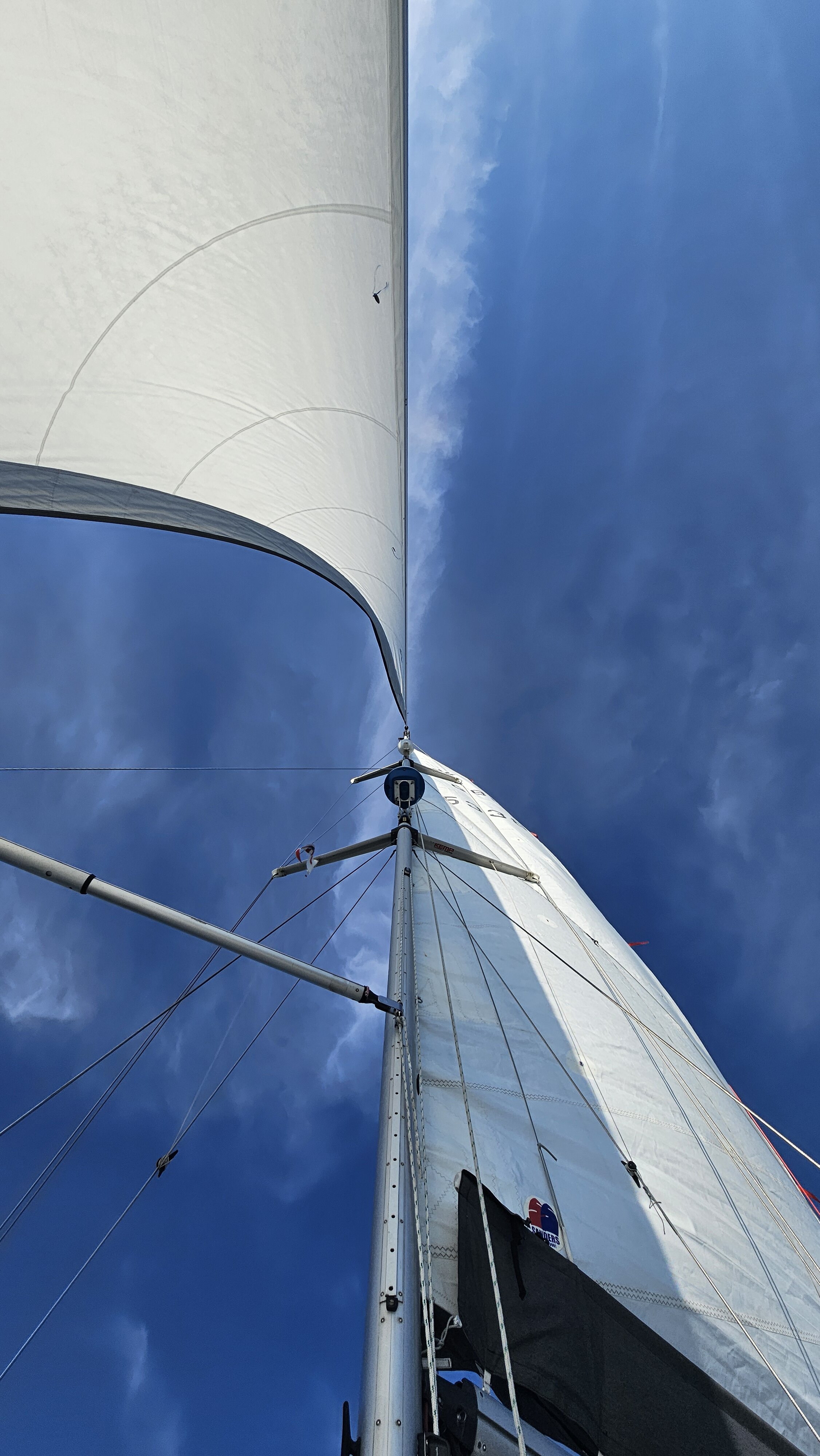

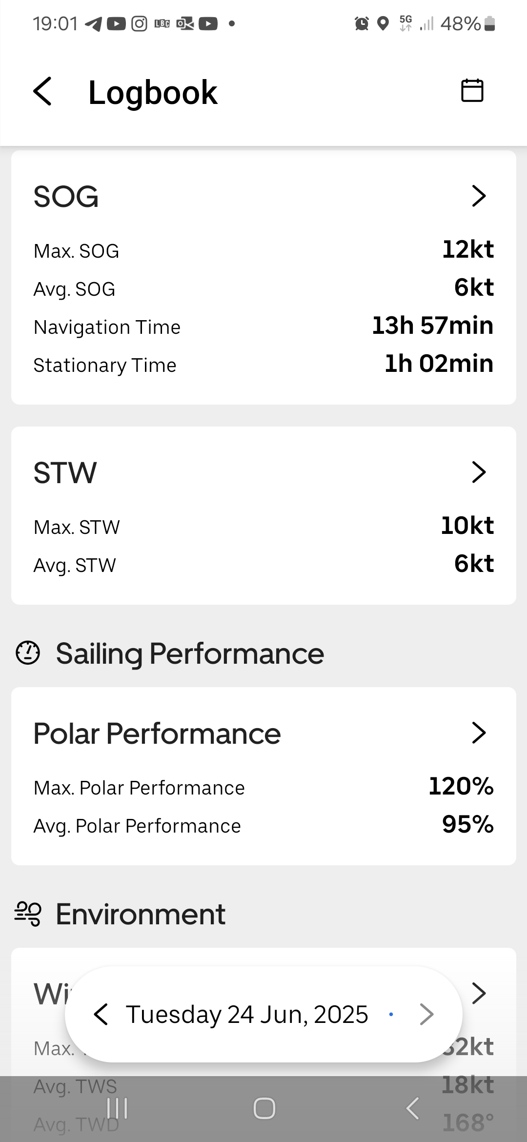

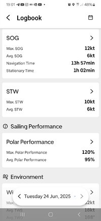

For downwind sailing the 336, as any masthead sloop, requires old school thinking. We use a foreguy and the pole with our 140% genoa extensively. Ragtime is a treat set up like this, able to handle 20kts with the wind upto 20 degrees either side of dead astern. One reef and a few rolls in the genoa and we are surfing in conditions gusting 30kts. This rig is simple and easy to work short handed and really easy to de-power. Foreguy and pole setup and practice really pay off.

We love Ragtime, and with the right setup I have no hesitation taking her offshore and across oceans.
